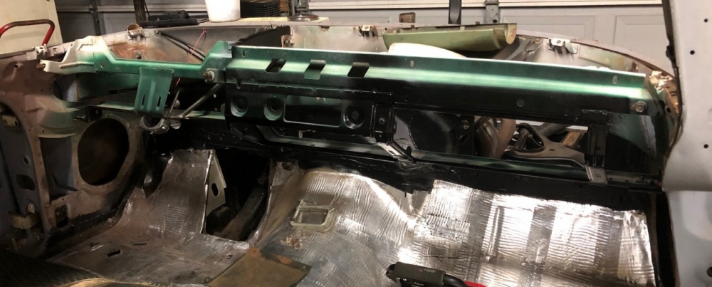

Took the steering wheel, column, speedometer/gauge unit out, then took the dash substructure out. Going to clean/sand and 'jamb' spray around the ashtray & glovebox, so when those are opened, it's finished. Also going to brush-paint the firewall behind it, so I can permanently bolt the dash structure back in. Down the road the dash tops and a few other like pieces will get professionally painted. Interior is going to black. Paint tomm.
EDIT :: prepped , primed & sprayed 1st coat this morning. Unfortunately, I noticed soon after that it was speckled with pollen. Have to wait 48 hrs, then do a quick 600-grit light sand & spray a 2nd coat inside.

Bolted the dash substructure in "permanently" tonight. Feels good. (8) 1/2-in bolts, plus (3) diagonal braces (for effectively 3 more bolts). Made thin rubber gaskets between the substructure and the body shell- hopefully no squeaks, ever. Feels very good.

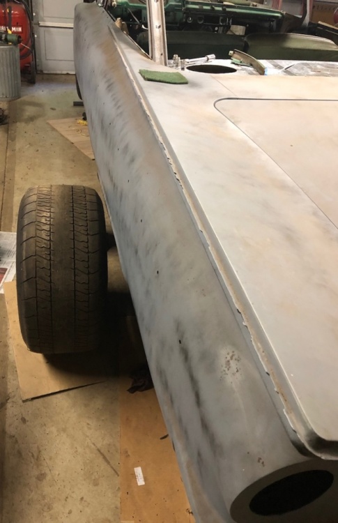

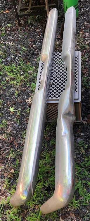

My car's original rear bumper on the right: bent, twisted & tweaked, beyond the obvious dent.
Got a nice straight core today (on the left); will save huge on the metalwork to try & fix the right one.

Yes; yes it is.
Figure around 2 grand for the rear & front bumpers plus 2 'eyebrows' over the parking lamps. But I haven't priced anything yet- not ready. Also want to get the speedometer cluster and 2 lower dash panels chromed. There's also taillight & headlight bezels. I think the 2nd grille I picked up is good enough to use. Everything else is stainless.

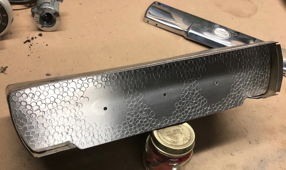

F I N A L L Y got the trunk spatter-painted. I bought the cans 2 years ago.
Not exactly how I wanted it to look- GM's application comes out smoother and quite a bit less 'peppery', but this isn't a restoration, and I can't think that I will actually use the trunk, so it should be good. Have an extra can left for touch-up, but I think it's 95% as of today, maybe 100%.
Another reasons how this isn't a restoration- I believe GM didn't start to spatter trunks (and different Divisions started in different years), until '62-63. For sure, P-62s are spattered, but Buick didn't start until '65. Buick in '59 shows zero metal in the trunk in factory form; between mats & cardboards, it's all covered. I don't have any of that stuff, and even if it were available repro (I think it is), my trunk's contours are different than stock.

Used up spatter can #4 in the trunk, came out pretty good. However, should have used a black undercoat- the self-etching primer was a grey-green color, and such changed the final color.
Then went ahead and dumped 2 cans of matte clear overtop, recommended as the spatter paint is partially water-soluble. That ended up a bit more mottled, but F it; I'm done. Still plan on a mat for the center section.

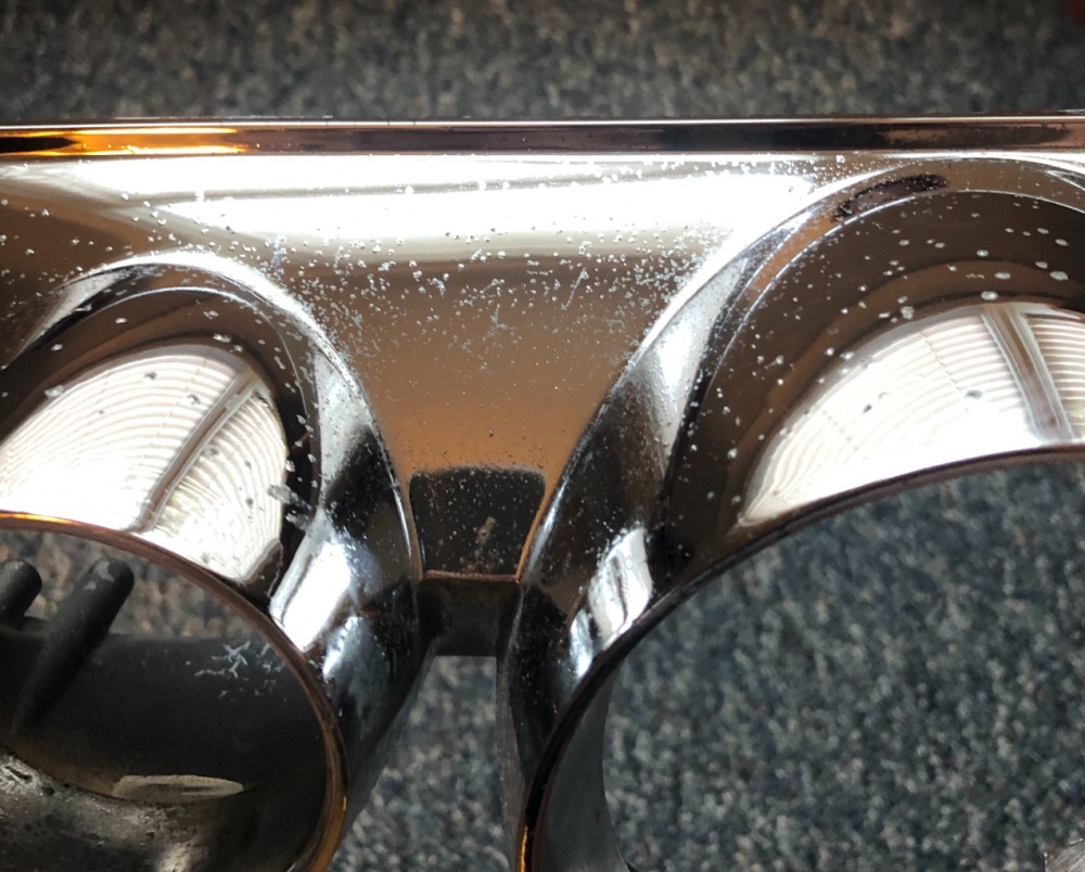

Painted speedo hood and 2 lower dash panels that house a variety of controls. Trying to figure out a modification to a tissue dispenser to have the face hinge down / hide a trio of aftermarket gauges.
Also polished up a cool ‘V’ emblem from a B-58 for the package shelf, and am exhausting a few last techniques RE trying to save the dash chrome vs. re-chroming. None of them are going to be an acceptable alternative to the real thing unfortunately.

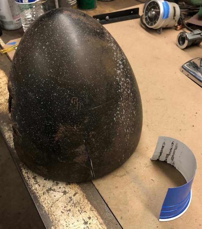

Also in line is fabricating a 'bullet' housing for the tach. There's a pic I think on page 3 of basically how it'll look, but I don't want the back of it & it's wires exposed. So I have a spare pair of rotted headlight bullets for my COE, and tho they're much larger in diameter, I'll pay around and see if I can make a 'bullet cup'. The blue Solo cup covers most of the tach when mounted, so you can see the size disparity I'm looking at.

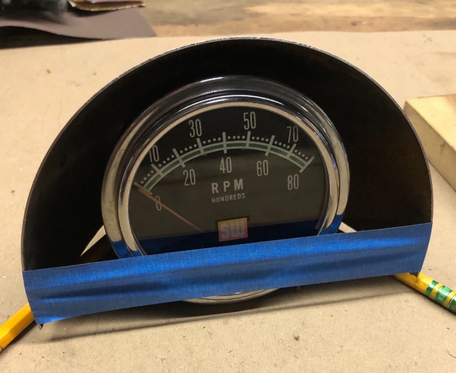

Did more work on tach housing. Difficult staring point; tach is 3.375” dia, headlight housing is 7.75”. Getting closer tho.
Prepped & primed hood springs. Also recently went over both hinge assemblies with a file; deburring & smoothing. Everything must be smooth. Going to try a phosphate bath for the assemblies instead of paint

finish tach housing / mounting
