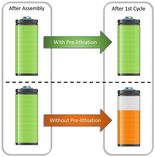

Who is IONBLOX? Founded in 2017, IONBLOX (Formerly known as Zenlabs Energy) is a next-generation energy company transforming the future of mobility be it by land or air. Ionblox’s proprietary pre-lithiated silicon oxide anode distinguishes itself by simultaneously delivering multiple performance attributes – fast charging, high energy, high power, and long life at low cost – pushing the limits of traditional battery storage technology and unlocking the viability of widespread electric transportation for generations to come.
Fossil-free mobility is the focus and IONBLOX is using a proprietary silicon anode in the battery instead of commonly used anode materials such as graphite. This allows Ionblox to unlock high-energy, high-power, and rapid charging capabilities in electric vehicles and aviation applications. Ionblox’s pre-lithiated silicon oxide anode is essential for high-performance applications requiring both high energy and power for fossil-free mobility.

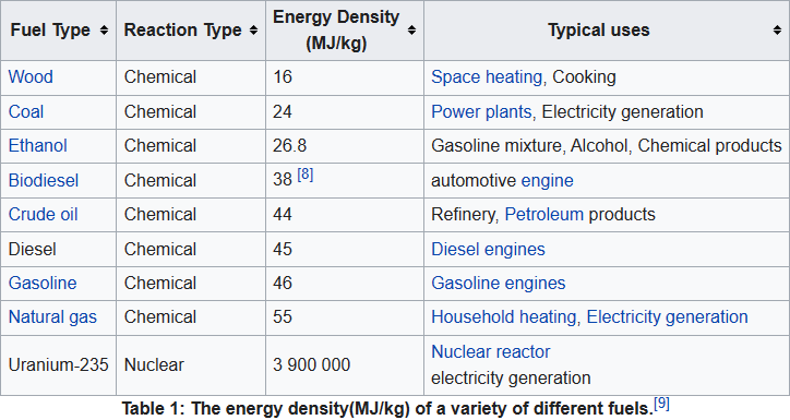

To better understand what IONBLOX has to offer, we need to understand Energy Density or better yet what is Fuel Energy Density?
There are many different materials that have stored energy, ranging from food, to diesel, to uranium. These materials are known collectively as fuels, and all of these fuels are used as energy sources for a variety of systems. Fuels that come directly from nature such as crude oil are considered primary fuels; fuels that have to be modified so they can be used such as gasoline are called secondary fuels. The table above shows energy densities for a variety of common fuels.
Energy density is the amount of energy that can be stored in a given system, substance or region of space. Energy density is measured in energy per volume or per mass. The higher the energy density of a system or material, the greater the amount of energy it has stored.
A material can release energy in four types of reactions. These reactions are nuclear, chemical, electrochemical and electrical. When calculating the amount of energy in a system most often only useful or extractable energy is measured.
Let's put this into simple terms to understand the benefits of this companies' technology.
Pre-lithiated silicon oxide anode-based cells distinguishes itself by the following:

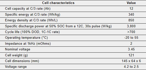

  • Idaho Labs has confirmed this with repeated testing of a 12Ah pouch cell, confirmed energy density of 315 Wh/kg

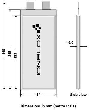

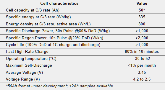

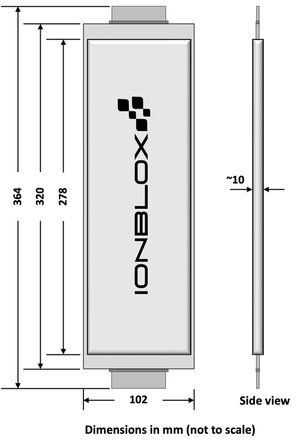

The IONBLOX Air Cells
Weight as we have seen in the auto industry is just as important an issue in the Airplane industry. Ionblox batteries allow more flight miles or increased loads over competitive products. The following charts above shows the cell characteristics and size of these state-of-the-art cells that offer high energy density with high power for the cells entire performance range.

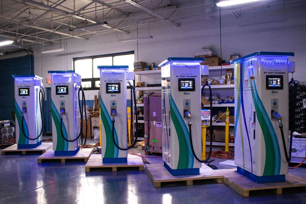

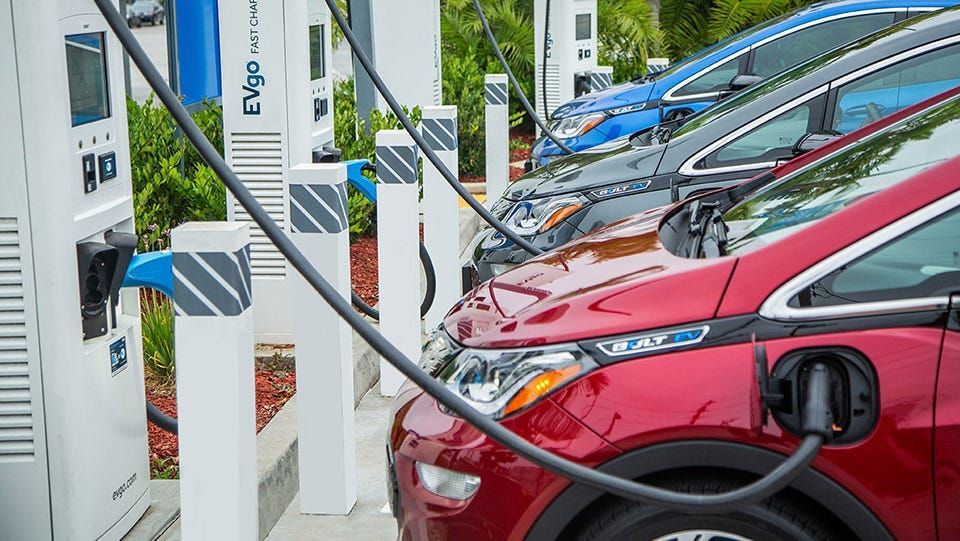

Ionblox cells have one of the farthest ranges of operating temperatures of any cell currently on the market. For the market to support mass adoption of EVs two things need to happen, first is the official funding and ramp up of Ionblox cell production which is happening now allowing them to produce 50Ah large format pouch cells which will go out to both auto and aircraft manufacturers for evaluation this year and hopefully into mass production in 2024. Second is the global installation of Fast DC chargers.
Companies globally are ramping up production of these DC or EV Fast Chargers to be installed. Here in the U.S. we have the IRA or Inflation reduction Act that is helping to put level 2 chargers in homes and Fast Chargers nationally on a scale of every 50 miles to make it easy for any EV owner to travel coast to coast.
