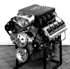

Here is also one engine based on Small block (DOHC setup).Weight is 226 kg
SwissAuto
Edited by dado
